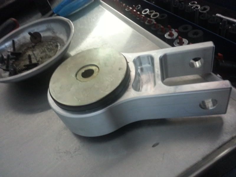

Just wanted to pop in and say I picked up the Steeda RMM today. I swapped the 77 durometer urethane inserts with the stiffer 88 durometer inserts. There are a lot of vibrations in the car at idle and coming off idle into 1st gear, with a little extra throttle though this solves some of the more severe vibrations, for most I would recommend staying with the 77 durometer inserts.
Here is how it looked out of the box with the 77 durometer urethane inserts

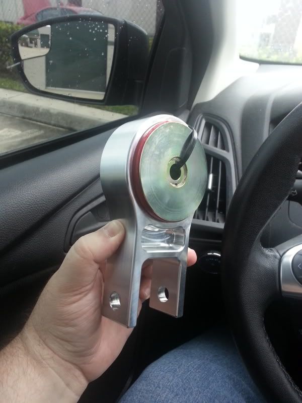

And here it is with the 88 durometer inserts
It fit just fine, only needed a longer bolt. No biggie

Notice any major change in how it feels??

It has improved the shifter feel, and with out the engine moving also feels like throttle response has been improved. Though with the 88 inserts it has alt of vibes off idle
