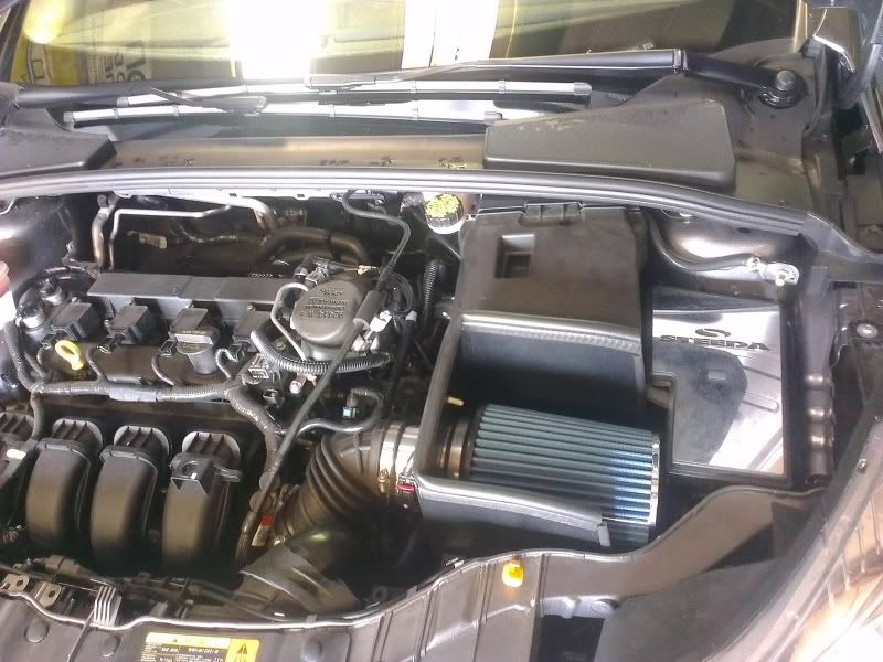

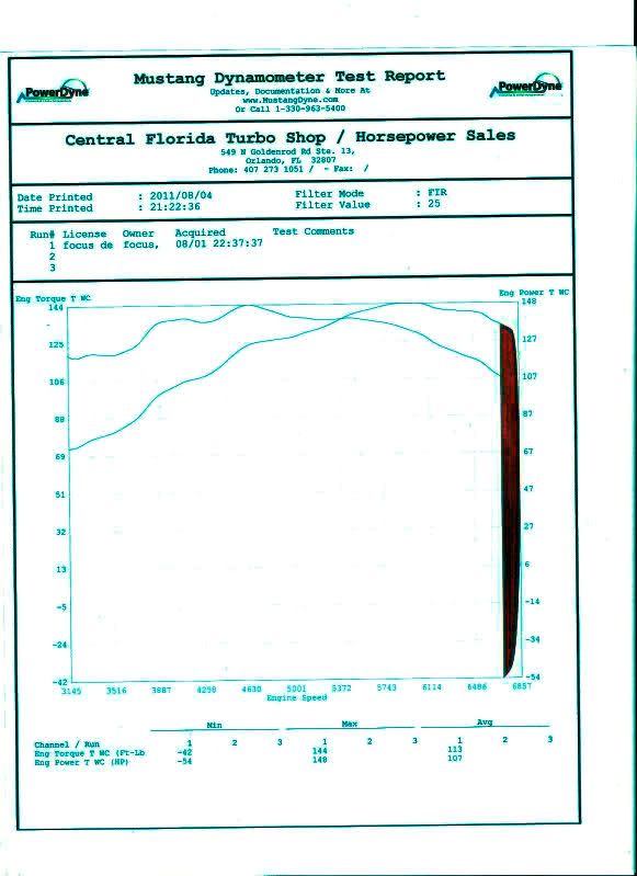

Went to the dyno today, to see how much the Steeda CAI and 2.5 magnaflow exhaust helped
170 HP and 163 TQ
Stock numbers
148hp / 143 tq
Intake for the hell of it
Here is the only video I got, this was a test... but you can see how ban the motor mounts are needed now

Mmm, seems the new 12's duratech are bolt on happy just like its older brother.
3,943 Posts
would love to see a/f to see if the stock injectors are keeping up with the mods on the 2012's but its great to see them making nice numbers from simple bolt on parts.

The torque number is 16 lb/ft more than the fswerks numbers. Is the Steeda intake and Magnaflow exhaust that much better or are there other factors causing the difference?
87 Posts
One of the guys with a 12 at FR this year put his blue titanium on McNews Dyno it had FSWERKS intake and stealth exhaust ran 150ish hp and said that it was running a tad on the lean side. ( He told me this, He did have his dyno sheet but i didnt look at it)
17 Posts
The horsepower numbers are on par with Fswerks but the torque difference is huge. If these numbers are correct I would spend the extra money
for the Steeda intake and Magnaflow exhaust. I believe the theory about the dynos could be correct, 16 to 17 lb/ft difference on a 4 cylinder is
too good to believe.
I change diapers now
14,444 Posts
Seeing as how the factory numbers all but completely account for the torque difference, i would say that makes the final numbers uncomparable.
Factory torque fsw = 132
Factory torque here = 143
1,186 Posts
Discussion Starter · #20 ·
What are you trying to say, that even with providing before and after dynos at the same shop my #'s are still invalid.
